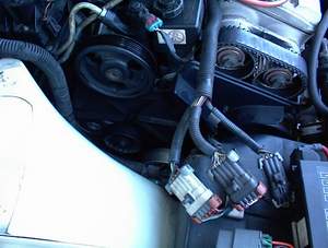

4.)  Remove the serpentine drive belt (a 15mm open-end works great for this)
5.)  If you follow the power steering lines down, you will notice a clip holding them in place, remove this clip (13mm socket and driver will fit)
6.)  Now remove the main bolt the clip was on (this is the first of the alternator bolts to get removed, and is easily done from the top on the car.

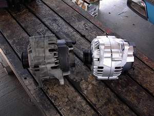

12.)  Remove bottom mounting bolt (13mm), remove alternator

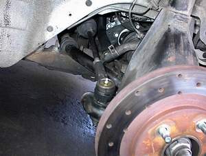

13.)  Undo the 18mm tie-rod bolt on the bottom of the lower control arm (has a cotter pin as well)
14.)  Take a ball joint puller (is basically a fork type of device) and hammer the tie-rod out. To do this, place the fork between the lower control arm and the tie-rod, then hammer the fork in until the tie-rod pops out. This does take some hammering but don't be careless
15.)  Once it is removed, put the key in the ignition and turn the steering wheel to the right. This pulls the tie-rod end inside the engine, giving you enough room to pull the alternator out of engine bay
Once it is removed, check the voltage regulator harness for possible open wires that can lead to electrical shorts and the early death of a new alternator.  Otherwise, the install is basically the reverse process as the removal instructions. To install the tie-rod, turn the steering back to normal, put the tie-rod into the lower control arm, it will go down just enough to put the bolt back on, then tighten with an impact wrench and install the cotter pin. Your wheel alignment will be off, so take it to get aligned after the work is completed. I chose removing the tie-rod end process because of the time and head-ached saved instead of removing the axle assembly.
