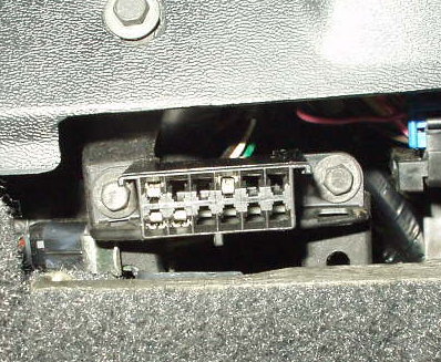

Looking the connection veritcally up towards the sky (if you were laying in the car) where the top of the picture is towards the firewall, the two ports that need to be connected are the bottom left.  For some other models they could be any other position, but they be always be side-by-side together.
1.)  Locate the dignostic connection under the driver side dash; it's a black plastic box that could be on either side of the steering column
2.)  Turn the ignition to the "on" position without the car running
3.)  Unfold a paper clip and complete the circuit with the two ports that are next to each other (see photo)
