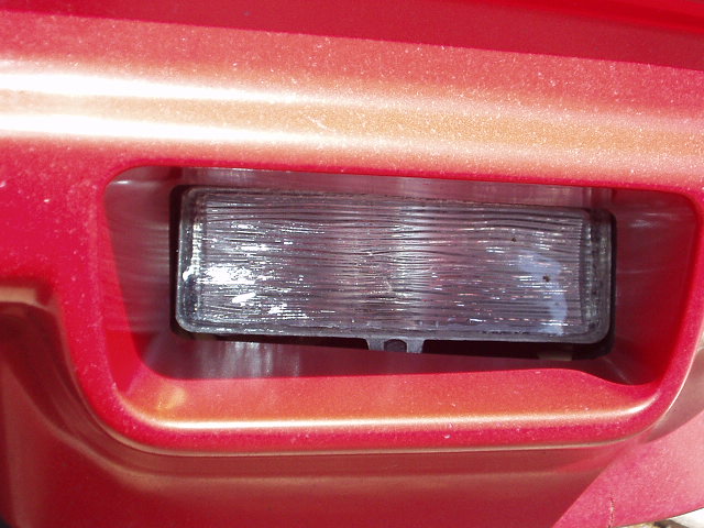

Ever had a rock or a piece of gravel gone through you fog light?  Didn't want to pay $70 - $80+ for a new lense?  Good thinking, because it's easy to replace the glass that crack or is extremely pitted.

3.)  Pry out the existing glass of the lamp, and clean off all old epoxy.
