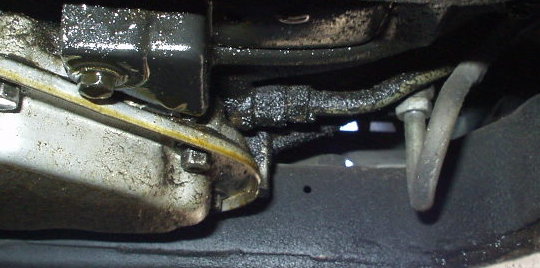

Underneath, when facing towards the driver side of the car, you'll find this: the front of the transmission pan and the two tranny cooler lines.  The horizontal line (full of grime and dirt) is the return line from the tranny cooler located, in front of the radiator; cooled fluid flows into the transmission there.
The vertical tranny line, just right of the return line, is the "out" line, pushing scorching hot fluid to the tranny cooler to prolong fluid life.  Picture from a 1995 Pontiac Grand Prix GTP, all other W-Body models will apply.
