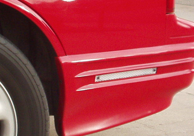

Alright, to stand out from the car, some owners throw on some flashy stickers and claim that their ride looks the best... now, I'm knocking having pride for the ride, but when it comes to exterior enhancements, I go for thing a little less noticable to the regular average driver. Clear side rear - markers are a great way to personalize your W-Body.... however, I want to be clear that these directions are for the 1988 - 1994+ Cutlass markers. You can apply the ideas and procedures to the Grand Prix / Lumina makrers; if anyone creates a set, e-mail to get your directions posted. But, before I proceed, I take NO RESPONSIBILTY for careless acts of others; do this procedure on your own terms.

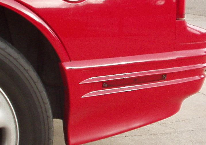

2.) My original plan was to pull off the red clear lense and make a new covering. But, since the two pieces of the markers are molded together, I obliterated them trying to rip em' apart. So, the first step is to cut off the cylinder (that holds the light bulb) right at the end of where it connects for the rest of the lense. Set aside for later.

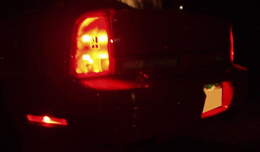

9.) Find desired colored light bulb, or use permenent marker to color bulb. Remove stock side-markers and install custom markers with color bulb.
10.) Take some photos' and show the rest of us!
