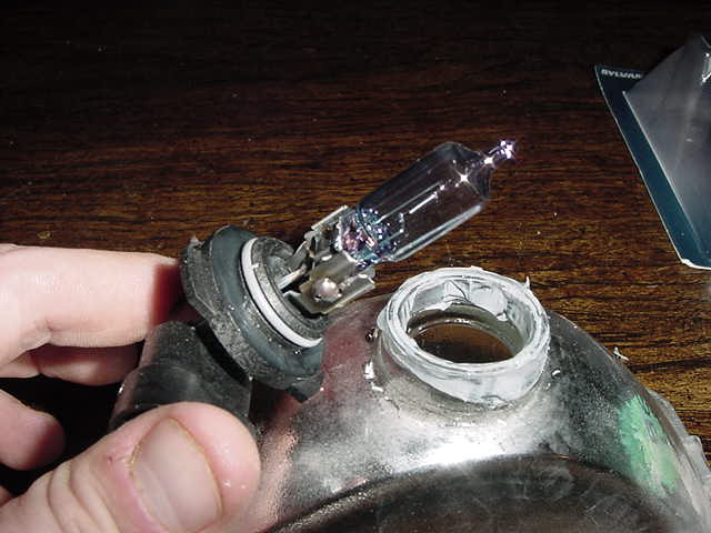

When removing the old bulb and aftercleaning off the old adhesive on the lens, the lens should look like this. The bulb that's held is the new replacement bulb and any style, color, and brightness is up to you. But before you install some hefty priced ones, double check to make sure they'll fit on your wiring harness on the car.

2.) Remove the old bulb from the lens. Use a large flat head screwdriver or a pair of pliers to pry between the base of the lens, and the plastic of the bulb. ** Don't get too forceful with it though, you can break the lense if your not careful. ** Work your way around the base of the bulb until it comes free from the glue.
3.) After removing the bulb, remove all the old glue. Use a hobby / exact-o knife to accomplish this. Make sure none of the glue is left in the lens; also, if lens is dirty, it can be washed out with some luke-warm water / soap solution. If washed let dry and inspect again for any old glue and cracks / chips.
Notice how the new replacement bulb sits flush on the lens; the old glue should come off down to the lens so that good contact can be made when installing / glueing bulb. Use some solvent or laquer linner if having problems getting good contact on materials.

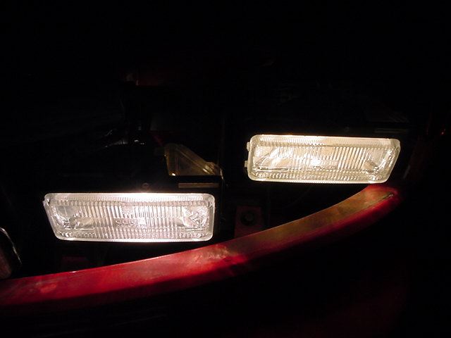

Finished project: notice the color tone differance of the left lens (replacement bulb) versus the stock headlamp. * Shown is dim (regular) beam in bright headlamp area to show difference in power output. It is NOT recommended to prolong use of mis-match bulb for the electrical circuit: could overload and blow fuse or burn up wiring harness. * The left of the left contains Sylvania Silverstars - model 9006 (dim). Thanks Luke for the pictures and installation!
