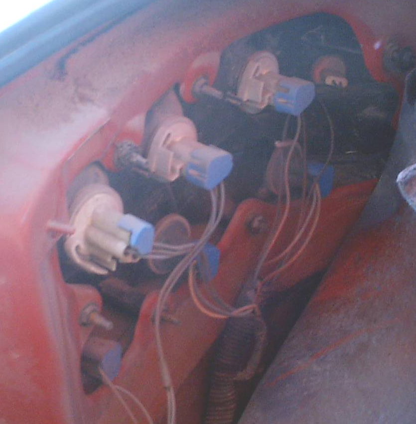

1.)  Remove either side tail-light (6 - 8 bolts per side in trunck behind carpet).
2.)  Remove light bulb(s) from assembly; recommend that you mark where they return to.

Once the rear taillight is removed, it's recommended to document / tag the wiring harness set the during re-installation bulbs are correctly put back in their selected slots.

8.)  Once dry, align and re-install tail-light on car.  Install appropriate colored light bulbs in wiring harness, and install wiring harness to tail-light.

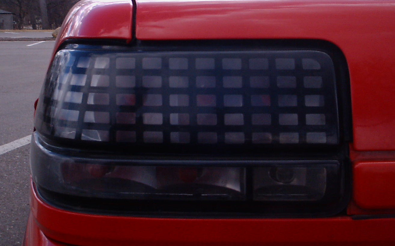

Shown is the completed cleared rear taillights on a 1991 Pontiac Grand Prix.  This particular owner didn't install a clear ceiling lense which will directly show the bulbs, and therefore not able disperse the light.  It's recommend to use the ceiling lense to increase overall visability to other drivers to provide better safety to you and your vehicle.
