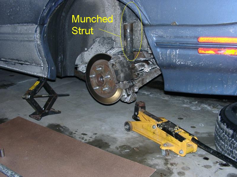

2.)  Raise the rear driver or passenger side of thecar using the jack that came with the car.  * Raise it where the owner's / service manual explain; there should be a notch just in front of the wheels for the jack. *  ** Be careful around a raised vehicle; use jack supports if available. **  Remove the rear wheel that is off the ground.

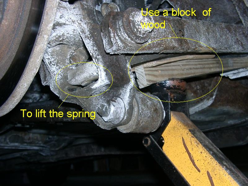

3.)  Use the hydraulic jack to raise the black monoleaf spring out of the knuckle; it only has to be raised ½" or so.  * You will need to life the spring to remove tension and pressure of the knuckle. *  Use the block of wood in between the jack and the spring for two reasons.  First, because you dont want to damage the spring, and the second is to keep the car from sliding on the jack because of the springs curvature. Position the jack as close to the knuckle as possible.  The jack will dig into the wood a bit to prevent the jack from sliding.  * You want support the cars weight on that spring; this relieves the pressure on the strut. *  In essence, you are compressing the spring with the jack, and the cars weight.

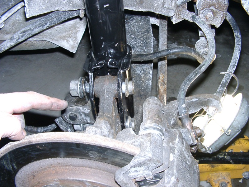

Use the 15/16" socket and breaker bar, and start loosening the nut.  You may well need to use that pipe here to give you some extra leverage and torque.  Once you get the nut semi-close to the end of the bolt, take the socket off, and wrap the nut once with just enough duct tape to ensure the socket wont fall off the nut.  Put just the socket on the nut, do not connect the ratchet here.  Get out the hammer and start pounding that socket/nut. It helps if you have a worn 15/16 short socket here, because your going to be hitting it pretty hard with the hammer. The bolts are splined so you cannot wrench them out, they have to be pounded out.  Once they have moved by hammering, dont take them completely out yet.
5.)  Loosen the upper strut mount bolts (15 mm), and remove them.  If a bolt head breaks off, use a "easy out" or bolt extractor to remove the bolt from the inside of the trunk.
6.)  Take out the bottom bolts, and remove the strut.  You will have to turn it a little to get it out of the way of the sway bar.
